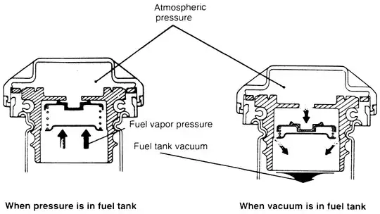

update When I open the fuel tank lid it depressurized giving a vacuum sound? Does this indicate some EVAP system error?

And as for @resident_heretic and the vacuum sound, er.. yeah, kinda, sorta. But not really. Here's my complete answer from another posting... Its a lengthy answer. And no matter how hot the days, nobody wants fuel vapor escaping.. that's a major no-no for an automotive manufacturer.

This is gas cap check valve. I tried to edit my post but It would let me. So here is a follow up for clarification. The check valve in the gas cap helps to regulate the pressure in the EVAP system.

Regarding the whooshing sound when you remove the gas cap. This could be a defective gas cap check valve. The check valve performs 2 functions. When the fuel pump takes fuel from the tank the fuel volume decreases creating a partial vacuum inside the tank causing the fuel pump to work harder. The check valve injects outside air in to equalize the pressure in the tank while the fuel pump is is in operation. When the fuel pump stops the check valve closes. A normally conditions a functioning fuel cap shouldn't make any noise at all , the exception being on very hot days -fuel vapor escaping. Change the gas cap with an OEM one.
