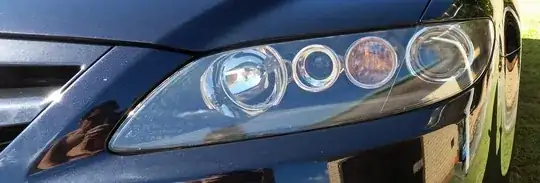

I own a 2006 Mazda 6 Luxury Sport in Australia, and the front headlights have 4 lights on them:
Front headlight, all lights off
It also has a fog light, which is not featured in this photo (but will be visible in later photos).

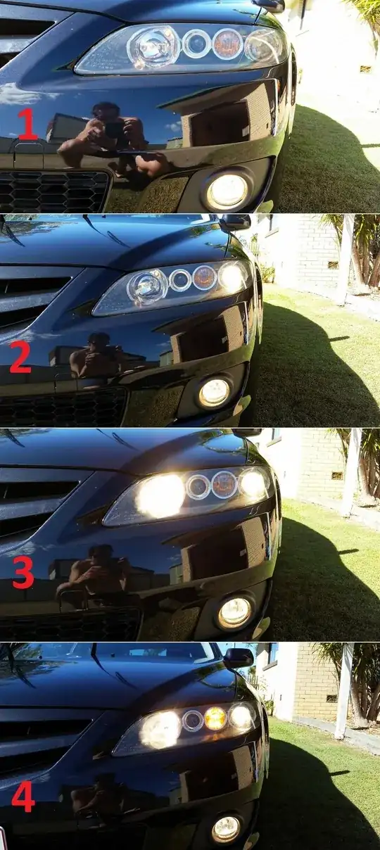

I cannot work out what one of the lights does (second from the left). The following 4 photos show the car with various lights on, explained below:
Front headlights, lights on
  1. Parking lights on: you can kinda see the small light on the big globe on, as well as the fog light
  2. Headlights on: you can see all of the above lights on, plus the full headlight on the right-hand side
  3. High beams: you can see all of the above, plus the large globe on (well, admittedly you can't really see the small light on)
  4. High beams + indicator: you can see all of the above, plus the indicator on

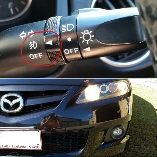

In none of the above can you see the second light from the left on. It is also possible to turn the fog light off (it's worth noting that in the picture shown, I have the fog light on, but that can be switched off which results in the light being off, as shown):
Fog light

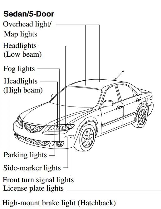

Looking through the Owners manual (pdf link) section 8-43, there is no light shed on the situation:
Owners manual

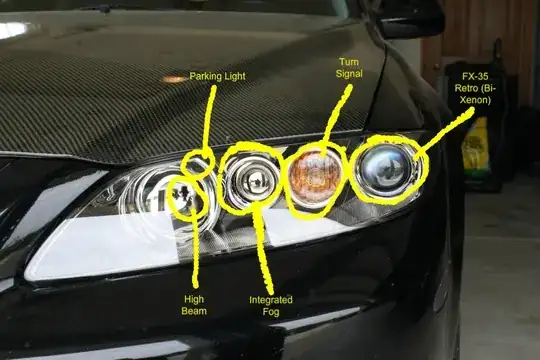

According to this that extra space is for the integrated fog light, which is probably where the fog light would be if you didn't have the separate fog light.
