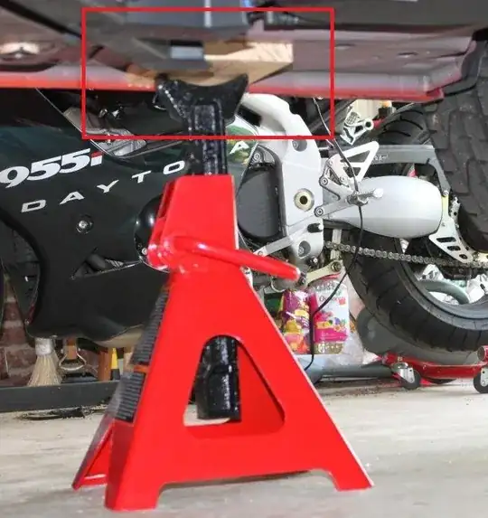

I have a 2013 2LS Camaro and I am looking to change the rear differential fluid and need to jack up the rear end of my vehicle.
Based on videos and enthusiast forums, people achieve this by putting a block of wood between the jack stand and the car along the side of the vehicle. For example: enter image description here
It seems like the wood could shift or split with the jack stand digging into it. Is this considered safe, or is this an indication that your jack stands aren't where they should be (if you need a piece of wood to distribute the load)?

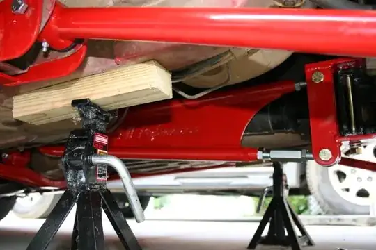

It is ABSOLUTELY safe. I do this all the time. Mind you I usually use a piece of 2x4, though. It spreads the load over more of the frame or body and keeps the jack stand from doing any damage. The jack stand does dig into the wood, which is much better than digging into your vehicle. The wood can crack. The wood can do a lot of things. But once the wood is settled, which is before you ever crawl under the car, it's good to go. If something should happen, it's before you ever get under the car.
EDIT: I wanted to add a picture of just what I've done in the past. I will almost always use a piece of 2x4 between jackstand and the vehicle. Waste 2x4 is cheap ... getting dents in the bottom of cars is not so cheap. This is the bottom of my previous Camaro Z28. If I didn't trust it, it wouldn't happen.

I'm going to take a different approach to this. As pictured, it's perfectly safe, and sometimes recommended to spread out the pressure to avoid damage.
However, I've also seen a pile of wood used to extend a jack's height...and then fall over. Don't do that! (The car in question landed on the freshly-unpadded jack with the oil pan...messy.)

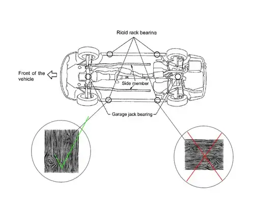

It’s probably safe - if you make sure the grain of the wood is aligned perpendicularly to any small pressure points - for example, the recommended jack points on most cars. Otherwise, it’s at risk of splitting, which would result in the car falling the height of the wood, and perhaps more. Some pieces of wood could have structural vulnerabilities - do this with due caution.
Against the grain - ok. With the grain - not safe.
The exception is if the pressure is evenly distributed along the piece, like @Paulster2’s photo shows - that’s ok.
