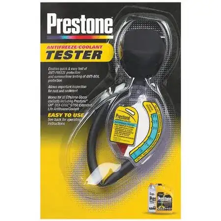

You can use a coolant mixture tester to test the coolant to water ratio. Any auto parts store should carry them.
Prestone Antifreeze/coolant tester
