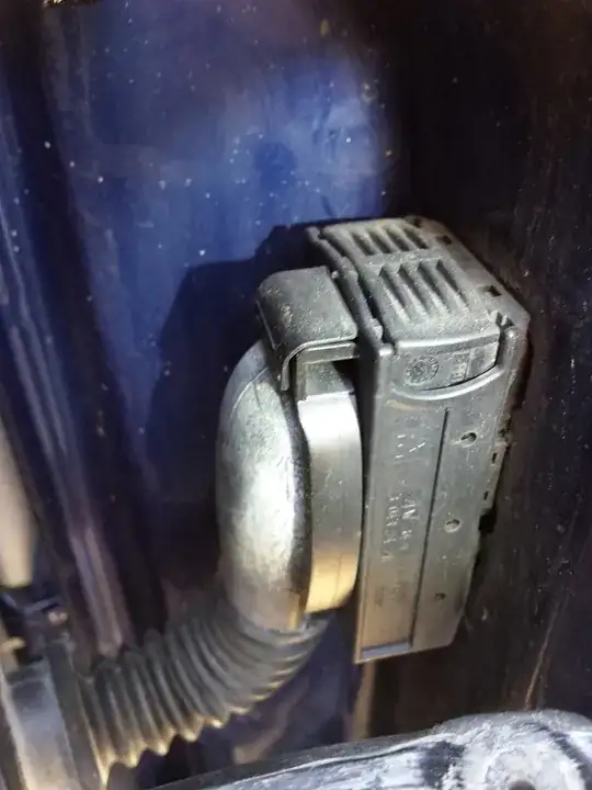

The front door electrical connector on the Astra Mk5 H, is a rectangular multiplug. Is there a special technique for pulling it off. Are there clips which must be released first?
Any tips appreciated.
(I haven't uploaded a picture as I'd like a reply from someone who has experience of this connector, rather than people just guessing)
Edit... picture added. I figured it out, though guesses are welcome!
Astra H Door Multiplug

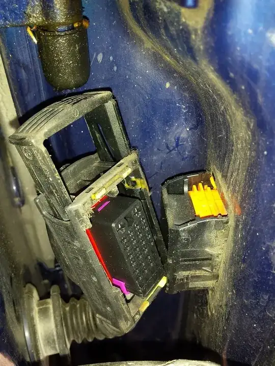

Pry up on top the center portion of the plug with a small screw driver and it will slide up and release the latch on the connector. Then the plug slides off.
Ben
  • 10,686
  • 23
  • 54
Ben is correct, although I'd already figured it out by this point. This connector contains a weatherproof seal, which combined with the 34 pins would make it difficult to remove. So this plug cleverly has a clip whose main purpose is to evenly prise the plug out of it's socket as you slide it upwards. A very clever design.
Here it is released Astra H Door connector (released)

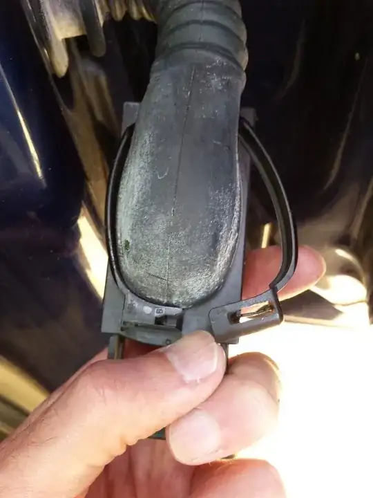

And the red-herring is the clip which keeps the rubber boot in place. Shown here unclipped enter image description here
