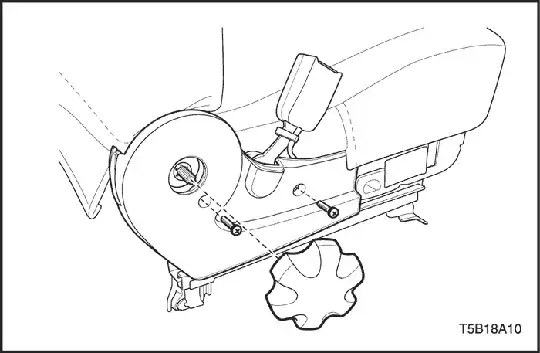

In that area some car seats have a small pocket, low on the side of the seat back towards the middle of the car, right above the plastic trim of the back adjustment knob... I don't think yours does but its easy to add one or sew in velcro loops using a curved needle. Eventually you can fashion something to attach it to that same seat plastic trim cover, or even between the cover and the seat padding (not completely tucked in there obviously), you might have to make a couple holes in the plastic to fix a pocket or loop but that's easy, if within reach you can directly use the same screws that keep the plastic trim attached to the seat. Exactly how you make the holder depends on where you place the tool (and what kind it is) but I guess it could be even just a pocket or a pair of double velcro loops held right against the side of the seatbelt buckle (made like an 8 one side holds the hammer and the loop on the other side grabs around the buckle). As for holding, can be hit and miss, if the accident is bad everything that isn't directly bolted to the car just gets thrown around.

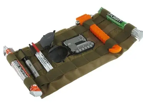

You could attach a visor panel on your sun shade and place the life hammer there. Something like this MOLLE-compatible visor could work:
molle visor panel
The MOLLE attachments give you plenty of versatility, and its size allows you to attach more than just the hammer.
