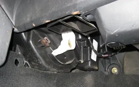

After a service call for a 2003 Vibe, the underbelly of the glove compartment looks like this: underbelly of glove compartment
As you see in bottom left of the image, one plug is missing. Also the white mechanical part seems too delicate to have been left exposed at the factory. Did a cover for this section just go missing? If you have an '03 Vibe, could you share a photograph of what you have?

That looks normal for a Vibe the only cover should be over the blower motor.

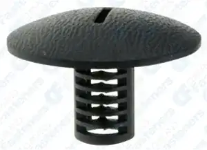

As to the missing plug I believe it's a white or black plastic retainer with a large flange.
I think this is it.
