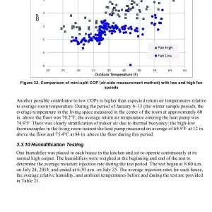

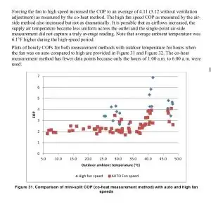

Contrary to my non HVAC engineer intuition:
bfw577 | Nov 29, 2019 06:11am | #6
I found a department of energy study that found COP increased 60% with the fan on high. This prettt much confirms my findings. Run your fan on high.
https://www.greenbuildingadvisor.com/question/mini-split-fan-speed-any-effect-on-efficiency
