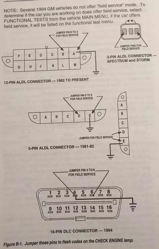

I have just finished a body off restoration of my 1989 Chevrolet Scottsdale 2500 HD.
My question, is there an OBDI or OBDII or do I need a adapter to scan it?
Even if I rebuilt the engine and transmission it has 90 thousand original miles on it before the restoration. Please let me know if there is a way to use my scan tool.

1989 is OBD1, my favorite scanner for this vintage GM product is a Snap-On MT2500, you can find them on eBay fairly reasonable. Be sure the scanner comes with the GM1 aldl adapter, a Primary cartridge and a Troubleshooter cartridge and cables for your model year.
You can short the proper pins (image below) to get the check engine light to flash any codes stored, do this with Key on, Engine off (KOEO). You will get long flashes and short flashes.
Code 12 means there are no codes stored, One long flash followed by 2 short flashes.
Long flashes are the first digit in the number code, followed by short flashes for the second digit.

89 is OBD1 and requires specific connectors and a OBD1 scantool. You can jump pins A & B on the ALDL (Assembly Line Datalink Connector located under the driver side dash) to make the MIL flash out codes.
