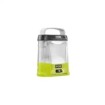

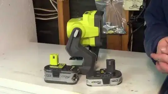

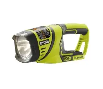

Examples from one manufacturer: Ryobi area light (I own this one, it has a provision for battery or mains operation) Ryobi lantern Ryobi flashlight
Other major makers such as DeWalt and Milwaukee have similar options. These tools share batteries with other cordless tools like drills, impact drivers, and saws. This battery sharing allows you to charge up several of the same battery pack and get use from different tools.

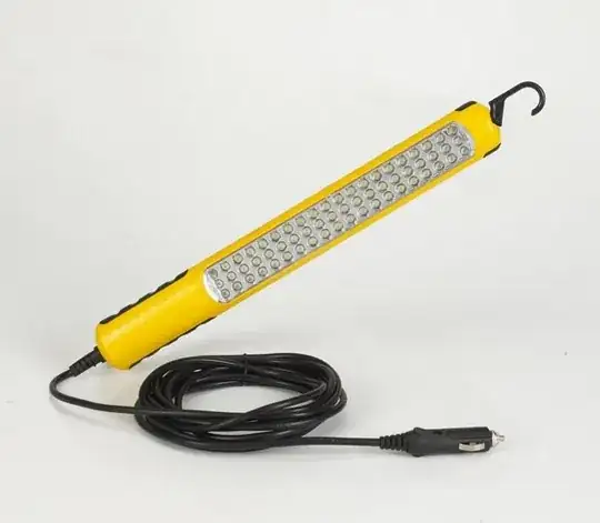

There are a number of ways to do this, but the two that come immediately to mind are battery-powered LED work lights. (A quick internet search will turn up many). Two varieties might be of use/interest to you. Some can be powered by the vehicle's battery which is convenient unless you're doing something like replacing a flat battery. Others have their own rechargeable battery pack inside and can be recharged elsewhere (via connection to an outlet) and then brought to the site. In your situation, I think I'd recommend the vehicle battery powered work light. I have one that looks like this and works pretty well. I leave it in the vehicle just in case.enter image description here
