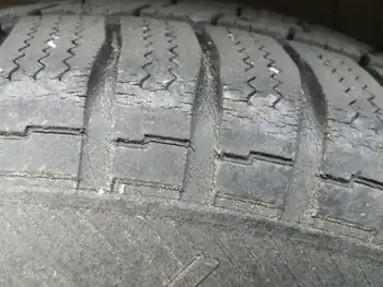

Rubber not only gets harder, but also more brittle, and get this little cracks, which indicate an old tire:
However, these cracks are usually only at the surface and don't build an additional risk.
