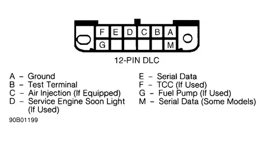

By jumping pin A to pin B on the ALDL the check engine light will flash codes for you.
