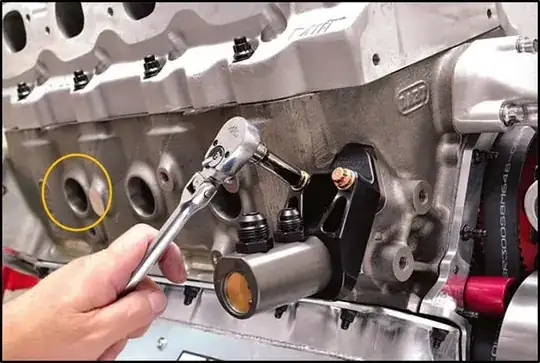

The second place to look for is in the side of the block where the freeze plugs are at. If one of these has corroded through, it would be dumping coolant like nobody's business. (The block in the picture doesn't have plugs in it yet, but there'll be some there before it gets used!)

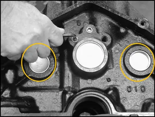

The last place, and most likely is another freeze plug, but at the back of the engine. This would be inside of the bell housing of the transmission. You'd see it coming out the bottom of the torque converter dust cover. (The plug in the center of the picture is there to plug up the hole where the cam goes; no coolant there.)
