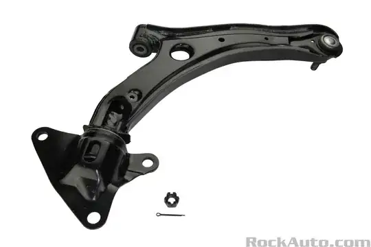

That is the way Honda does a lot of their suspension parts. Take for instance, the part below. It isn't sold with bushings, but rather as a complete unit. This is the complete A-Arm from the front end kit for your Jazz (called a "Fit" here in the US). With this in mind, I don't think they are telling you anything out of the ordinary, though it does sound like it from the outside. This is what I'd expect to change if I were doing the work.
