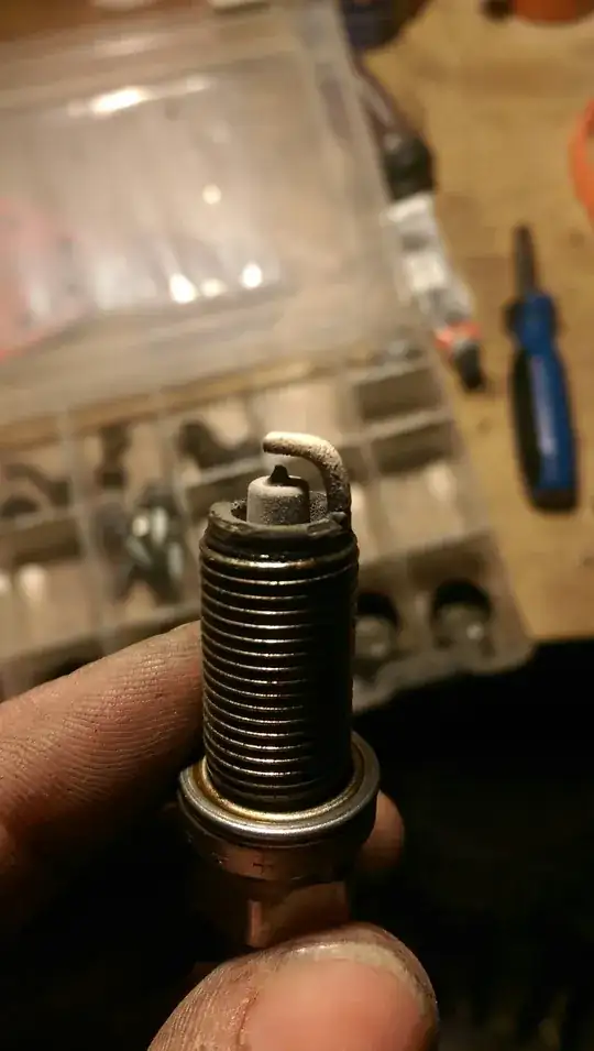

UPDATE 1: Every single spark plug looks like this

You can do a leak down test but look at your spark plugs first
If your burning oil you will see it on your spark plugs. They will be black and have buildup on them. If you find one or two that look that way and all the others are very light in color to tan then you probably have oil getting into the combustion chamber.

I think your definitely thinking along the right line, I would just check your spark plugs first. Physical inspection yields good data. Have a look at them for your first run on data collection then move onto harder things to do to gather more data to come up with a conclusion.

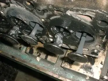

Oil consumption depends primarily on two things: the valve guides and piston rings. If the valve guides are worn, or if there's too much clearance between the valve stems and guides, or if the valve guide seals are worn, cracked, missing, broken or improperly installed, the engine will suck oil down the guides and into the cylinders. The engine may still have good compression, but will use a lot of oil.
engine valve deposits
Heavy carbon deposits on the valves are caused by worn valve guides and seals.
Worn valve guides can usually be restored a number of different ways. One popular method machine shops use is to ream out the guides and install thin bronze or cast iron guide liners. Knurling is another procedure that can reduce valve guide clearances. With aluminum heads, the original guides can be driven out and replaced with new ones. With cast iron heads, the guides can be reamed out to accept new valves with oversized stems.

I agree with Paulster2. Leak down test is about compression rings, not oil control rings. You can have good compression/leak down and consume oil. I would look at the pcv system. If there is too much "blow by" the pcv cannot keep up. Make sure there is vacuum to the pcv, and enough vacuum. A stopped up pcv vacuum port/line will cause excessive oil consumption and can cause leaks and/or oil consumption as pressure builds inside the engine. Fuel injected engines do not smoke like carbureted engines did. Looking at he plugs will help in figuring out where the oil is going. Dark, sooted plugs are oil burners. Whitish plugs are normal. PCV valves are cheap. I would change it and make sure all breather tubes are clear.
