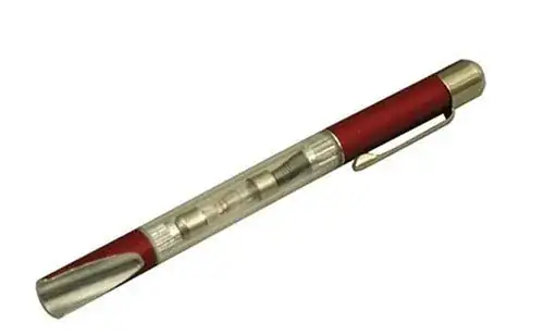

I don't know how easy it would be to find locally but you can use an inductance spark tester.
http://www.amazon.com/Lisle-19380-Spark-Tester/dp/B0002STS3U

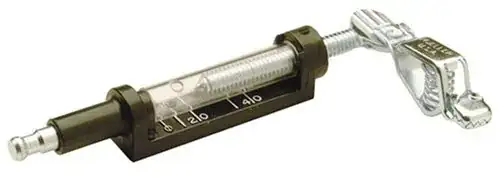

Another way to see if the coil pack is firing would be to pull a wire out and use either an adjustable spark tester.

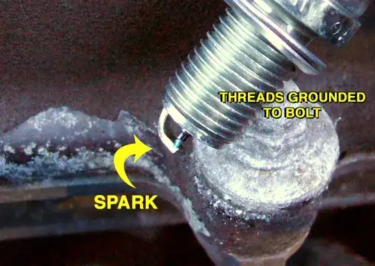

Or take an old plug/pull one from a cylinder insert it into a plug wire and ground the electrode.
http://autorepair.about.com/od/troubleshooting/ss/coiltest-manual.htm#step2
