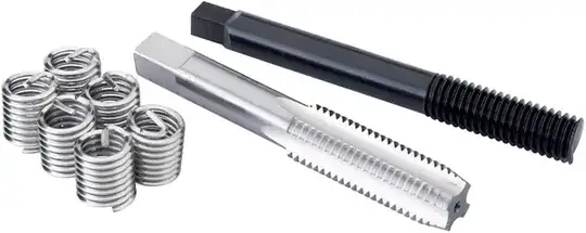

If it is the oil pan bolt holes that are stripped out, using a Heli-Coil thread insert is the professional permanent solution.
Heli-Coil is the inventor of this repair method, but there are other brands now available that do the same thing, they are sold in most Auto parts stores here in the US.
Using Epoxy to do this type of repair is similar to using bailing wire to hold the exhaust pipe up off the ground, a temporary fix.
They sell Kits for every thread size, the Kit includes the inserts, insert tool, and the correct tap to tap out the hole for the insert to screw into.
You will need to know what the thread size is to order the correct kit.
