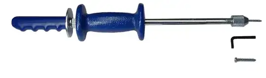

Roll the window up and pull the door panel, using various sized wood sticks (long ones for leverage) attempt to push or massage out as much of the dent as possible. You can gently use a hammer on the end of the wood stick to help with the stubborn parts, once you have done all you can do from inside pull the rest of the dent as best you can using a Dent puller. It's up to you how far you want to go and make it look good with body filler and paint.

As discussed in another recent answer one good method for paint-less dent repair (which is really the only DIY type of dent repair) is to use glue on plastic dent tabs:
These come in different shapes and size for differently shaped dents and are applied to the dented area with non-maring hot glue. They are pulled with a handle or slide hammer and can be peeled off once the pulling is completed.
