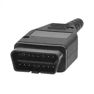

The Panda will most likely have OBD connectors:
so you'll need the appropriate cable and adaptor. For completeness sake, here is a link with pictures showing where to find the connector.
