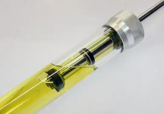

Yes, it's true that the gas and oil separate on the shelf lying horizontally. It's also true that they separate on the shelf if stored vertically, piston rod up or down.
But it doesn't matter. These shocks are twin tube shocks. The oil and gas are separated. If you have some gas below the piston it will work it's way to the top upon operation.
Here's an image of a 'twin tube' shock
The 'dead spot' on first operation after a period of time not in operation is normal. You can feel it in steering dampeners, struts, shocks and motorcycle forks. It's just more prominent in feel when there isn't a spring as a component due to the lack of resistance to operate it off the vehicle.
