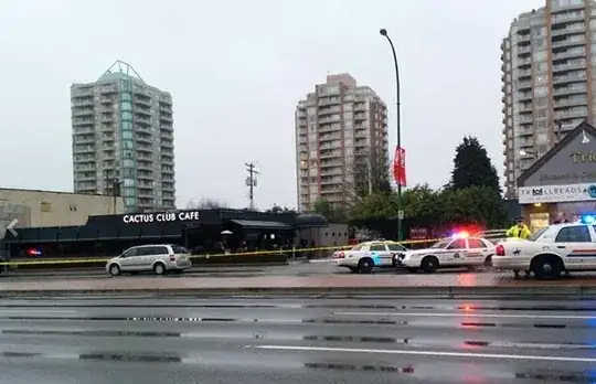

What you are most likely experiencing is the pull from tires when breaking on uneven surface or road with grooves from heavy vehicles.
If you have rather wide, sticky, square tires, this is what it would be.
Notice how water stands in sort of lines, that's where the grooves are formed from vehicles. Depending on if you are closer to the right side of the grooves or left side, your direction of pull will be different:
