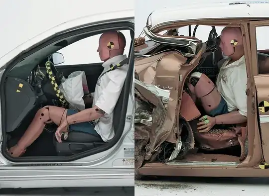

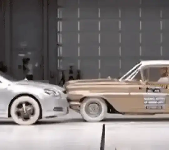

In 2009 this crash test was done between a 1959 Chevy Bel Air and a 2009 Chevy Malibu.
Click for video
Aftermath of crash Source: http://www.iihs.org/iihs/sr/statusreport/article/44/9/2
The aftermath of the crash shows how the modern "crumple zones" almost completely protect the driver's area in the 2009 whereas the 1959 driver would certainly be badly crushed.
In addition to crumple zones built into the frame, there are other thoughtful features like collapsible steering columns and as a high tech option the car will call and report the accident to emergency responders for you.

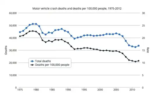

Consider this graph showing deaths per 100,000 people in the US (black line, right axis) and note the dramatic fall:
Deaths on the road
Then consider that this has come despite a large rise in the number of miles driven per person and the number of cars on the road. The major contributing factor to this is the many improvements to car safety: better brakes, crumple zones, air bags, anti-lock braking systems, lane warnings and so forth. So although classic cars are safe to drive, they are much less so than modern cars; it is - as always - up to you to assess the relative value that you put on the pleasure of driving a classic and the higher risk to your physical safety.

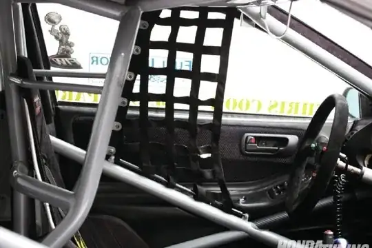

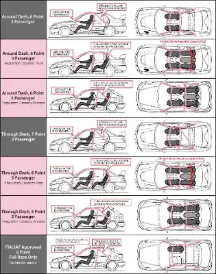

You can attach & use safety equipment like a racing seat & harness, helmet, even a roll cage: enter image description here
This article about Racing Safety Equipment has lots of info, including a warning about roll cages and helmets (especially when putting steel bars near your head):
An accident involving a roll cage and a driver without a helmet will never end well
This site (http://www.cuscousainc.com/products/roll-cage.html) sells roll cages (apparently pre-fabricated) for several models, including it looks like 5 passenger vehicles: enter image description here

The TV show 5th Gear did a 60 MPH moderate overlap crash test between an old real wheel drive Volvo and another heavier real wheel drive car. They said that there would be no survivors, which is absolutely true for the drivers. But that is only part of the story. The rest of the people in the cars would have a greater chance of survival than they would in a modern stronger car due to the softer structure. Watch it here: https://www.youtube.com/watch?v=R-_oOYzNcAw
