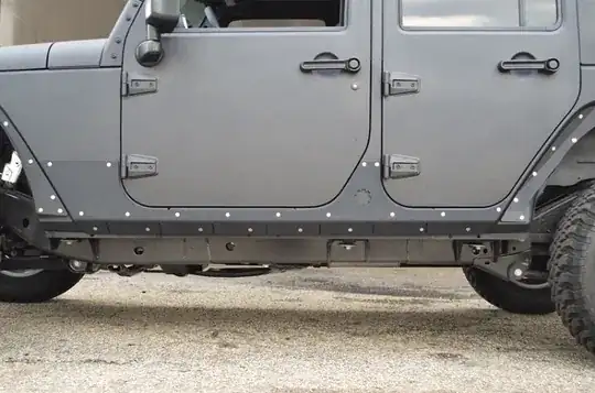

You may also use a rocker guard type product as shown.

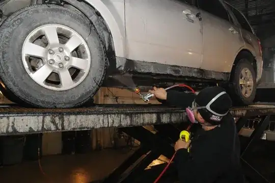

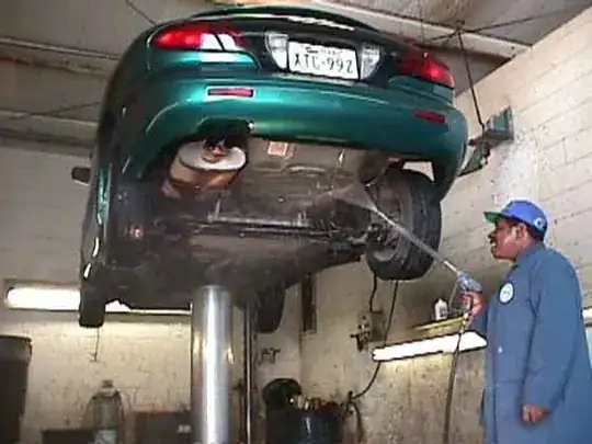

To my personal taste, I would seal with epoxy primer, rubberized undercoat, and then oil undercoating to protect even further. Application is very straight forward if you are working with clean metal. If not, make sure you are not applying the products over unprepared surfaces.
Oil undercoating is the process of spraying oil on your vehicles underbelly to aid in rust prevention. Most vehicles will have plugs in their doors which can be removed so they can be blasted as well. For optimal results in climates like Canada, you can do this at least once a year.
Here are pictures of the process.
