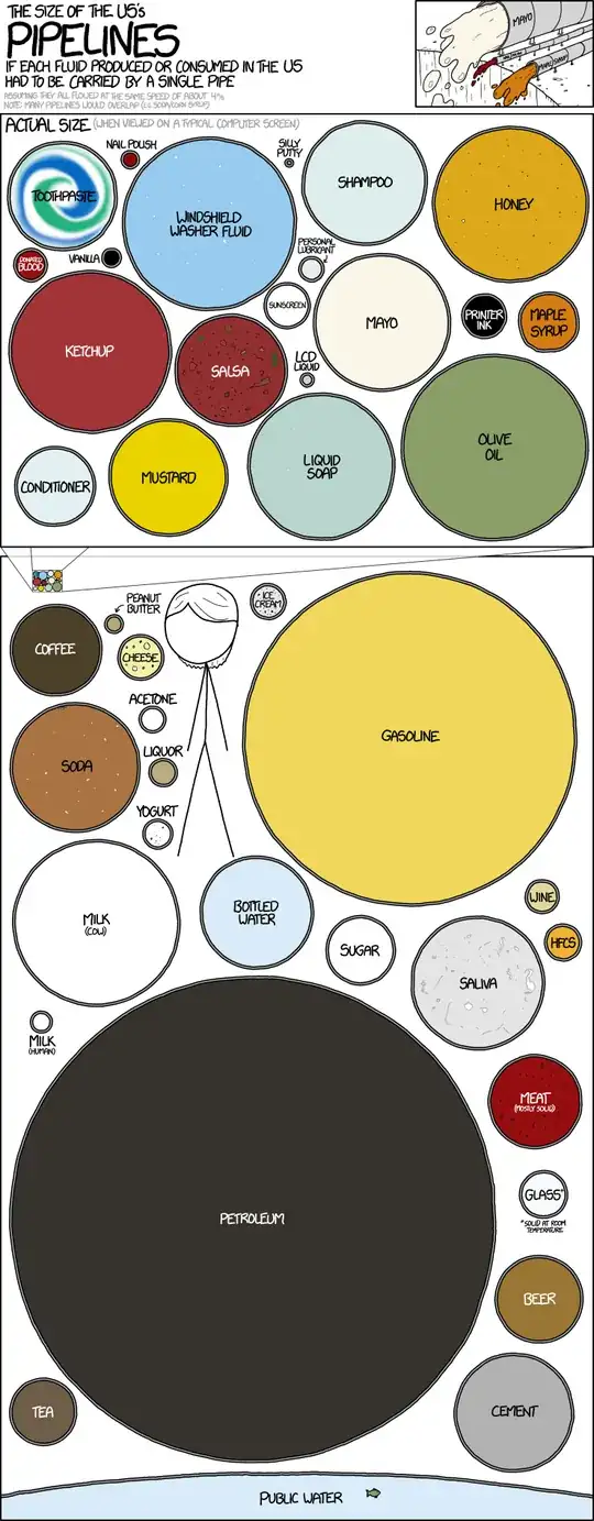

Obligatory XKCD image: Gasoline volumes are insane
[[Side note: a puddle the size of these pipes, about 1mm deep, is how much each person uses up each day on average.]]
Volume is the secret sauce. Volume is why petroleum/gasoline is the only liquid other than water that gets piped around the country rather than trucked. And volume is why we cannot produce car fuel artificially.
