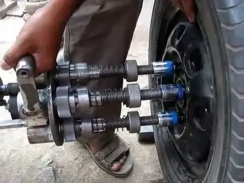

I have my own opinion on why this is the wrong thing to do. In the early 1980's, Lancia engineers, working as service crew on the Lancia 037 Group B car, devised a wrench which was essentially multiple equal length extension bars with magnetic sockets on the end. The "drive" wrench would run in the opposite direction to what was required and turn a central cog to drive each socket at the same time. This meant all lug nuts could be removed and refitted by a single mechanic.
Multiple lug nut wrench
