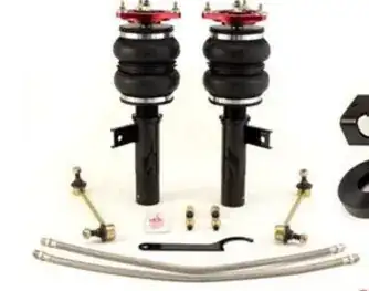

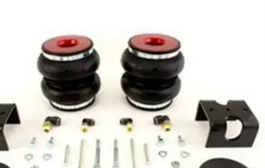

Not necessary depending on the kit. Per your vehicle a company called Air Lift does make an air ride lowering kit for your vehicle that has air bags for the rear that would simply replace the spring:
and air struts for the front that will replace the coilovers:
![enter image description here
The issue you would face is if you were to install an air strut, would you need to trim the spring pocket to allow the bag to sit in because you cannot have it rub. Sometimes it is a simply swap and replace so if you were to ever sell your vehicle you could remove the air system if you wanted.

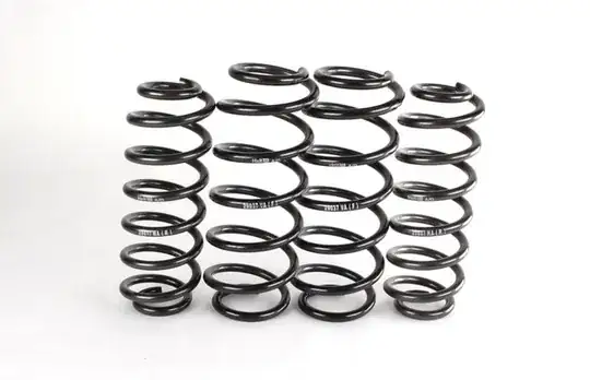

Fabrication of a system can be extremely costly if you're not capable of doing it yourself. Even the air ride lowering system alone starts off around two thousand US dollars and that's not including install time. That type of system will set you back so I would encourage possibly looking into a mild lift kit by replacing the springs that will assist in adding around 1" more lift for around two hundred US dollars plus whatever the install would be.
Example springs:
