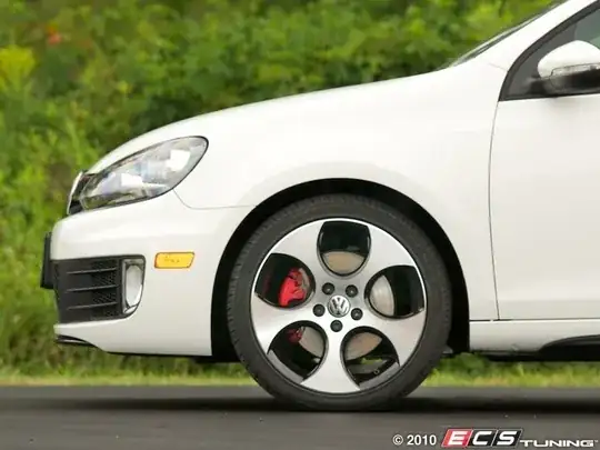

I bought a lightly used VW GTI last year, and it has alloy rimsenter image description here
I have been in SoCal, so the weather is pretty fine, but we're moving to the midwest :(.
Should I plan on buying steel crappy-ugly-only-for-winter wheels and tires? I know many people in snowy/salty climates swap out wheels in spring and fall, but is it necessary? Will it drastically (adversely) change the handling of the car?
