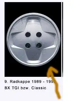

I'm mostly an OEM kinda guy. But the original hubcaps on my Citroen BX are horrible from any point of view. hubcaps I was thinking of replacing them with rims but I have no idea what I should be looking for. I was told all I need to take into account was the diameter and I think mine are 14". But I'm trying to gather info and it looks like I should take into account Pitch Circle Diameter too.
If this is the case how should I start looking for rims or is searching on any online shop for "14 inch rims" sufficient?
Also how can I measure or find in a manual or online my measurements?
Thanks
