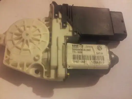

First of all sorry for my english. I have a Golf mk4 1.4 16v 2 doors There are about two weeks that it started to make this click when i try to open the window and it just wont open. I tryed to contact some store that have used parts and i asked for the window motor. They asked me if my car have 2 or 4 doors, and when I told them that have 2 doors they said no we dont have. Now im looking for the part on ebay but i dont know whats the difference between. The windows motor looks the same. This is the part i found on ebay but im not sure if it gonna work with my car. Does anyone know if there are differences between a front left motor for a 4-door golf or a front left motor for a 2-door golf.
1J2959801D FRONT LEFT WINDOW GOLF MK4 MOTOR VW

Thank you guys for your advices. Yesterday i bought 2 regulators for the 2 doors. Now it works perfectly. 2 days ago the driver's door stuck in central locking and the window motors circuit doesnt pass power to the door lock. I had to open the locked door from the inside then at the moment that i changed the motor, the door opened from the door switch of the central locking. I found the parts in very good conditions at a used spare parts store for just 12$ each.
Thank you guys, Have a nice day
