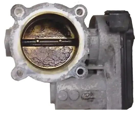

It's hard to diagnose without more information, but it could be that your throttle plate was stuck open. This might explain:
  • the engine revving even after the engine coming to a stop (fuel injection management compensates for more air by adding more fuel)
  • the feeling that the engine is running rough (misfiring in the event of a lean condition, while the fuel injection management is still in the process of correcting the lean condition)
What could cause the throttle plate to get stuck like that?
  • carbon build-up on the back of the throttle plate
    The fix will involve just cleaning off the carbon build-up after gaining access to the back of the plate.
    CBU on Throttle body
  • if cable-operated, maybe the cable or spring has snagged on something
