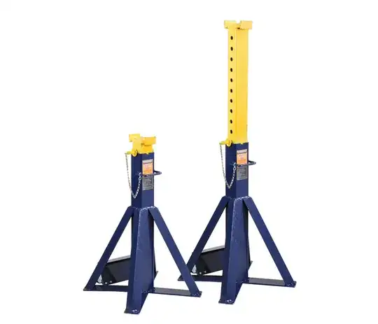

You could always look into jack stands that are typically used for heavy duty trucks and semis. One time I had a lifted truck I had to go to Northern Tool and purchase high reaction jack stands:
Item link
That said I wouldn't recommend using anything other than the jack stand. Even if you are using a block that block could still break from the pressure being applied and you would be crushed. Safety should always be top priority. You just need bigger stands.

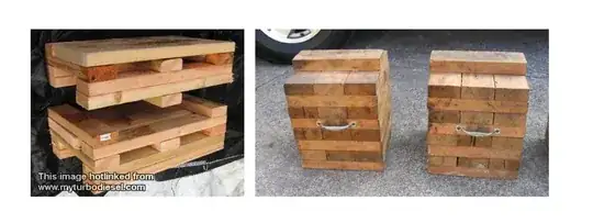

Wood. It's plenty strong. Cut some 2x6 or 2x8 and stack them accordingly. This is the most cost effective way to solve your problem. The only danger you will encounter is if you used rotten wood.
I realize the picture is not 2x6's, etc, but, it displays the idea.

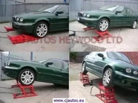

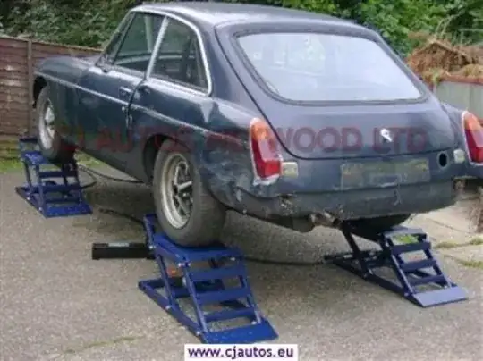

Hydraulic car ramps are a great option if you can source them.
Four ramps
They give oodles of clearance by lifting the wheels themselves. You have to drive the wheels into them before using the hydraulic pump to lift the ramp.
Montage

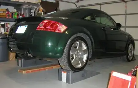

Drive-on ramps operate on a similar principle - just drive onto them
Rhino ramps

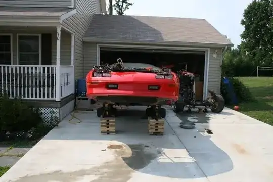

I have used a wood block to get an extra 1 1/2", but will not use multiple wood blocks (as suggested by others) because they become too unstable. A better choice is concrete blocks or large concrete pavers. Or perhaps building wooden wheel stands.
wooden wheel stands & wooden jack stands:

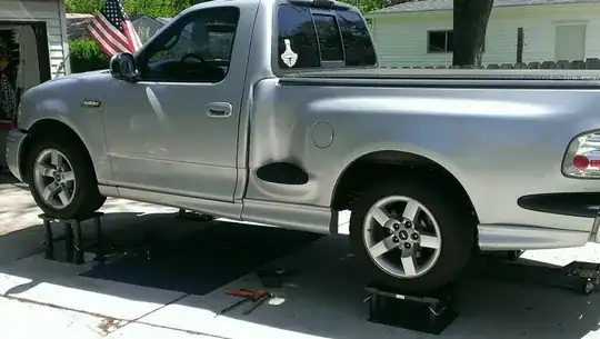

13

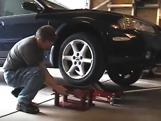

Adding this as an additional answer since I was reminded of it after seeing Zaid's answer. Hydraulic lift jacks are fairly pricey so I always wondered of an alternative and there is an item that has come out that is on my wish list called My Lift Stand. It is great if you do not need to access the brakes or require a wheel to be off and it adds additional lift beyond a typical jack stand:
pic from site:
Since some recommended in comments a pic without the jack here is another reference:
I did look on the site for a pic if just the stand itself but I have only found pics of the jack in use. If someone can find a pic or take a pic of the stand please feel free to edit.
Screen grab from the demonstration video on the seller's site:

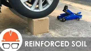

Engineering Mud
Layers of sand/earth sandwiched between sheets of cloth.
I was initially quite skeptical about it, but this video blew my mind:
Video thumbnail
Sand Castle Holds Up A Car!- Mechanically Stabilized Earth
