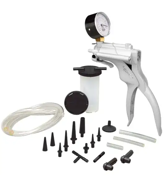

Two effective brake bleeding tools are speedbleeders or vacuum evacuation tools.
*Here is a speedybleeder
Here is handheld vacuum pump.
