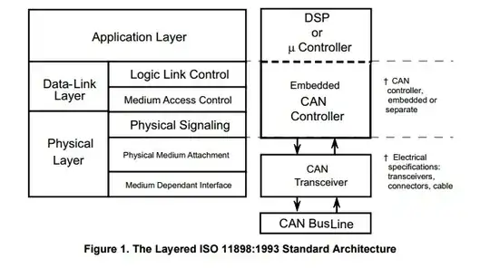

To help describe this, here is a diagram of the standard architecture for these kinds of system:
Standard CAN bus architecture
Your PC would have to be at the other end of one of these connections on the "CAN BusLine" and hence would need an embedded CAN controller to talk to. The device you're trying to test will have a matching stack inside it, and you need one connected to your PC in order to talk to it. It's all possible by finding an evaluation board for an embedded CAN controller who's interface is serial or USB.
