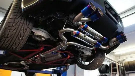

Yes! Absolutely you can have this done. The quality of work may vary depending on the level of experience of the shop you commission to do the work but you could end up with something like this, if you want.
