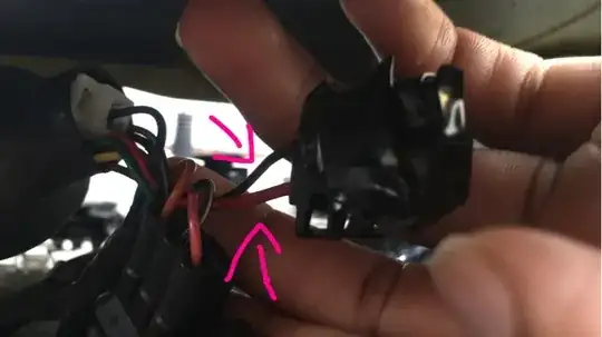

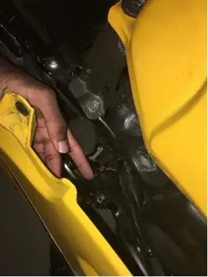

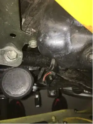

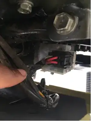

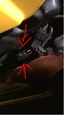

I also found a plug to something on the right side of the bike in between the oil tank and the battery that was not connected. I couldn't find no place that the plug could possibly go to. Even with the plug as it is the bike would make the noise but eventually I would get nothing. Any thoughts?
left side of bike is picture 1
right side of bike is picture 2

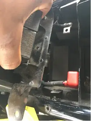

  • You have a tip over sensor attached to your battery box. That's the plastic shell your batter rests in. The tip over sensor has a black rubber encasement that wraps around 4 sides of it. The tip over sensor is black. It has an arrow stamped on it, not the rubber but the plastic. You want that arrow pointed up to the sky. If it's not pointed in that direction, the bike won't start.
