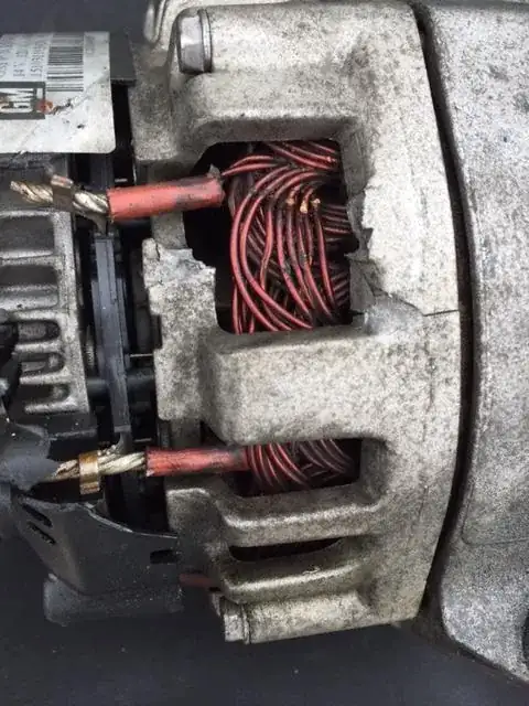

Update
I pulled the alternator yesterday, and saw this. Not sure how I missed this when I pulled it off of the old engine. It's worth noting that the previous motor threw a rod from the #1 cylinder. I think the rod grazed the alternator.
Looks like there's a short in the coil.

Oh wow, there's definitely something funky going on with the electrical system.
With regards to the P0563 and P0621, have you tried getting a live reading of the voltage from your scan tool or a multimeter when the car is running?
My advice - get a decent automotive electrician on the case. Your run of the mill mechanic isn't the right person for the job
