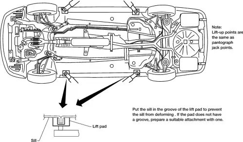

I have a 2000 Toyota Camry with 143k mile on it. My garage is not terribly wide and I need to jack up just the front to work on the brake calipers and pads. The normal jacking points according to the manual (Chilton's, etc), and according to the Toyota owners manual, is between two notches along the weld on the frame rail just inside of each wheel (just behind the front wheels, and ahead of the rear wheels). This is for a different model Toyota, but the jack point positions are essentially the the same.
Jack Points

I have the rubber pads to protect the pinch welds for my stands. Do I need something else / better to protect the frame?
The rubber pads should do the trick, as long as the pinch welds do not crush them down to the metal of the jackstand itself.
I'm nervous about using that 2x4 because that seems very unstable.
You really should not be nervous at all about using 2x4's placed between either the jack and the car or the jack stand and the car. There are several reasons why you want to use them, but the main reason why I use them is to distribute the load of the car over a broader area, which helps prevent damage to the car from the jack stands. The place I usually put them in a situation like yours is to put the 2x4 just inside the pinch rail where your image shows to put the jack. This area has the same basic support as the pinch rail does. By putting them just inside (away from you towards the inside of the car), you'll most likely find a flat/secure spot where you won't have any wobble from the 2x4 like you'd see at the rail. Ensure your 2x4 is long enough (I like mine at least 12" in length) to support the car without breaking in half (long ways). You'll find this not only supports the car, but will be very secure in the process.
Where on the frame can I place the stands? They have to be far enough apart to evenly support the frame, and that means wide placement. It's a front wheel drive car so things get complicated for finding strong frame points.
One place I've found on most front wheel drive cars to support the load is where you find a tie-in point for the front suspension. In the diagram you provided (and as @Ben mentioned), you'd be looking at the subframe mounting points. These areas will be well supported due to the fact they need to be in order to do their job. Placing the 2x4 along this area will distribute the load as well as provide excellent stability.
