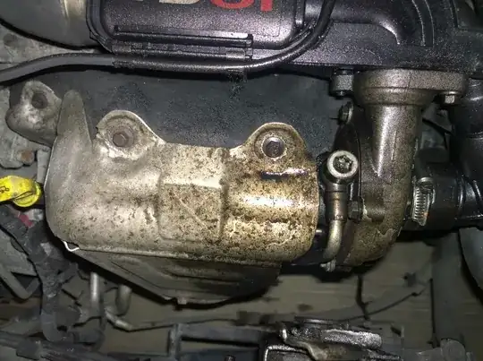

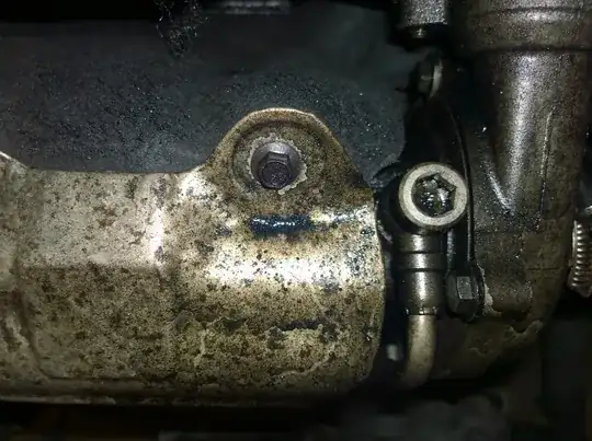

The oil leak is slow and builds up after time. Seems to get worse if driving over 70mph. Car is ford fiesta 1.4 tdci.

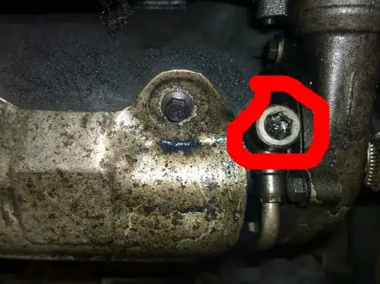

The picture where i've highlighted red circle - the oil seems to build up here, wells up. Any idea what that part of the engine is?

I would also suggest looking at the gasket that's right next to the red circle. You can see the bolts holding the two halves of the turbo together in the picture. If oil is leaking into the compressor side, leaking out of the shaft bearings or just generally getting blown out of a failing gasket, it could certainly make that sort of a blast pattern.
I would also expect that hex hole to fill up first if oil is flying around since it is essentially a bowl waiting to fill up with under-hood crud.
