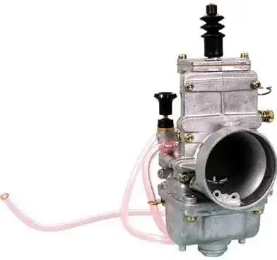

The 1999 model of your bike uses the Mikuni TM30x1 Flat Slide Carburetor

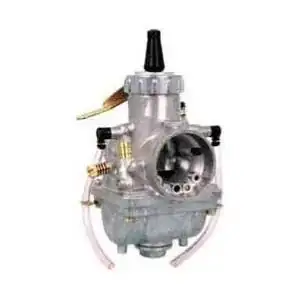

Older models use a different carburetor model. The slide is round.
Here is an image of the flat slide carburetor.
Here is an image of the round slide carburetor
