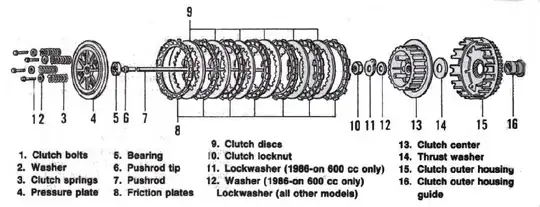

The engine itself can be ok and not receive any damage from pulling in the clutch while breaking other than it is additional wear on throw out bearing for the pressure plate within the clutch.
The throwout bearing is number 6 in the image below.
