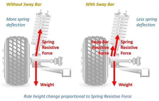

Adding a sway bar will result in a harsher ride
I've tried to explain the mechanics with this side-by-side graphic:
Graphical Representation of what the sway bar does
Explanation
  • When a wheel encounters a ditch, the weight of the vehicle on that wheel will cause it to deflect downwards. This causes the suspension spring to extend, causing a resistive force to act in the opposite direction.
  • Adding a sway bar introduces an additional resistive force in the mix, which reduces the amount of spring-resistive force. This results in a smaller spring deflection compared to when no sway bar was present.
  • Less spring deflection means that the vehicle body will want to follow the wheel into the pothole more than when the sway bar was not present.
Since a picture's worth a thousand words
This is the effect of the sway bar
Ford Escape graphic
It's little surprise that sway bars and off-roading rarely go together
