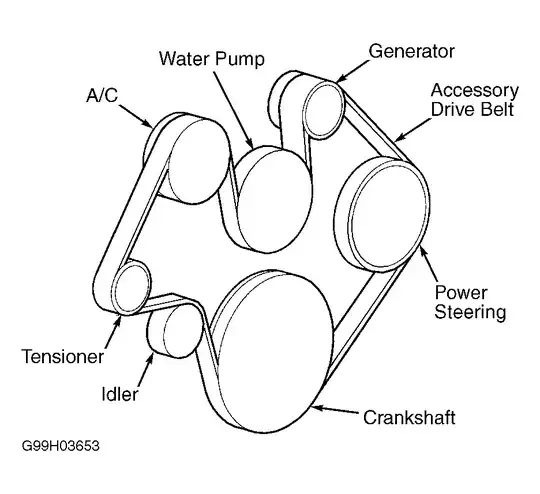

I've had the A/C discharged on an older truck (2001 Grand Cherokee 4.7L v8), and soon I plan to remove the entire A/C system, specifically, the compressor.
  1. Is there anything that I should be concerned about in doing so (defrost and cabin cooling are not a concern).
  2. After removing it, is there any reason for me not to just use a shorter belt? It will clear everything without issue. The alternative being to make a bracket and put a pulley in place of the compressor pulley.

Looking at the routing it may work with a shorter belt. But it may not have enough tension to drive the water pump without slipping. Dorman may make an A/C delete pulley/bracket. Which would keep the original belt routing and length.
