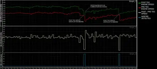

I found an interesting page which explains misfire detection in detail. The ECU measures the crankshaft speed at the top and at the bottom position of the cylinder and compares them with each other. If there is a misfire the two curves become closer because the cylinder did not accelerate the crankshaft.
Misfire detection via crankshaft speed
