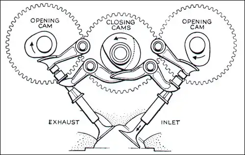

In an answer to another questions @Ceshion introduced a fascinating kind of valve train that I have never heard of, desmodromic valves, as introduced by Ducatti. That answer is here:
What are the various kinds of tappets / lifters and the advantages / disadvantages of each
and here is the image she provided as an example:
Desmodromic valves example

I can actually answer some of this question as well. There are other companies that use them, while Ducati is the best known. Ducati uses them in their racing as well as streetbike engines. Mercedes Benz is another company that uses them, namely in F1 engines. The theoretical limiting factor, the best I understand it, is heat and friction. There's no practical reason to work the engine so hard as to reach those limits. They are somewhat less reliable, due to the complexity and number of parts that need to stay in sync, and power delivery is similarly less reliable. There are, in fact, springs in most desmodromic valve setups, they just aren't used for cam following. They are, however, used to reduce slack in the system, as can be seen in the following:
This also shows an alternative setup to what I described in the other post, in that this example uses the same camshaft for both opening and closing the valves. They are adjusted with shims, labelled in the diagram above. This is what makes them such a nightmare to service, since there are two clearances on each valve that interact with each other.
