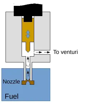

The choke of a scooter consists of a dedicated choke nozzle in the fuel reservoir and two narrow drillings leading to the venturi (the pipe where the air goes through):
When the motor cranks and the choke is active, the slight underpressure in the venturi sucks in extra fuel through this drillings. When the choke is inactive, a piston (golden) moves down and closes the drillings.

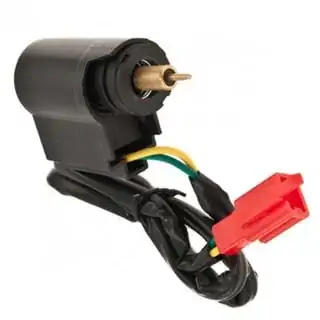

In reality, the choke looks like this, and you can easily recognize the piston, which is the brass barrel with the needle:
Inside the black choke body, there is a small cavity filled with a liquid like oil, and an electric heating element. When power is applied, the oil heats up and expands slowly, pushing down the piston. When power is removed, the oil slowly cools down and retracts the piston.
The choke is directly connected to the alternator, i.e. it only gets power when the motor is running. It takes several minutes for the piston to move from the "fully retracted" to the "fully extended" position, and the difference is really small, may be 5mm (1/5").
