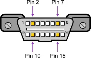

Determining protocol from OBD-2 pinout
Standard        Pin 2       Pin 6       Pin 7       Pin 10      Pin 14      Pin 15
J1850 PWM       must have   -           -           must have   -           -
J1850 VPW       must have   -           -           -           -           -
ISO9141/14230   -           -           must have   -           -           optional
ISO15765 (CAN)  -           must have   -           -           must have   -
Please note that other pins may also be fitted. They usually connecto to other (non-engine) ECUs or provide various signals. Generic OBD2 tools are not capable of "talking" to other ECUs than engine. For diagnosis of other control units such as ABS, airbag, audio or body modules you need vendor-specific software such as FiCOM (Fiat/Alfa/Lancia), FoCOM (Ford/Mazda) or HiCOM (Hyundai/Kia).
