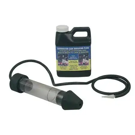

At a guess? From your description I'd bet it has a blown head gasket. The only way to tell if this is so is to do a sniffer test (search for "block tester") at the radiator. There are testers which, when in contact with hydrocarbons, change color from blue to green to yellow. Here is an example:
The only way the fluid will change color is in the presence of hydrocarbons (like I said), so if it changes at all, you know there is an issue.
