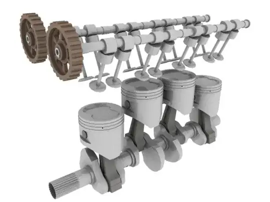

Ok, let's start from the same picture so we're on the same page:
Simplified Engine layout
These engines are four stroke engines, which means the piston goes up and down a total of 4 times, twice up, and twice down for each cycle.

To lay this out, lets look at how many times the shaft rotates with each stroke. From the diagram you can see that a full up and down path of the piston makes for one revolution of the crankshaft. That means in a four stroke engine the shaft rotates twice (two revolutions) for every four stroke cycle, which means one power stoke for every two revolutions of the crank. So, if the crank is turning 1000 times per minute, that would be 500 power strokes (firing of the spark plug) on each cylinder in that one minute. Since there are 4 cylinders, there would be 2000 sparks in that one minute across the whole engine.
And no, the piston does not produce the same torque on every stroke. In fact it only produces torque on the power stroke. The other three it's just along for the ride.
As for why RPM does not vary constantly, the plugs don't all fire at once. The power strokes are spread out so that during the rotation of the crank the power is divided amongst the 4 cylinders so one of them is almost always producing power and turning the crank. In addition, the flywheel has a lot of mass, and tends to smooth out the roughness of each individual cylinder firing during it's power stroke. Otherwise it would be a much rougher cycle.
