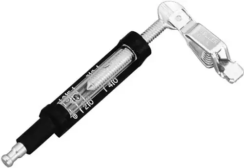

On a separate note.
When testing for spark it is recommended to use a spark tester. Using a spark plug is a poor test of the ignition system. In free air the spark plug gap poses a very small load to the coil. The spark plug loads the coil when it is in a compressed mixture of air and fuel. The spark tester is either rated for a specific Kv or is adjustable to different Kv. By adjusting the tester to the Kv rating of the coil and then watching the quality of spark the health of the coil can be assessed. The spark should be bright and blue not dim and orange.
