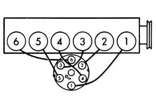

Cherokee "89" firing order Found out the timing order is 1-5-3-6-2-4 on 99% of 6-cylnders. There's an extruded cylinder the housing between 1 and 5.

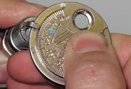

proof of spark plug gap sizeThe spark plug gap is 0.035 (thirty-five thousandths [of an inch]). Thank you for reading.
